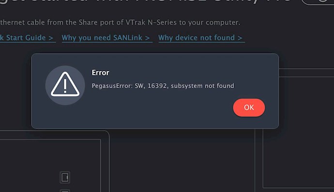

Hi there, my R4 unit has started powering off. if i remove all drives, it powers on.. no warning lights/ issues.. but if i put any drives back in from a cold start or hot swap it turns off.
