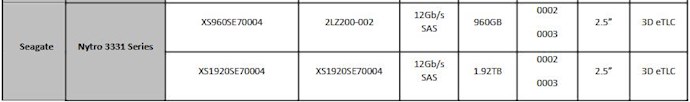

Hi Dean,
Some Seagate Nytro SSDs have been tested...
The 3.84 TB SSDs have not been tested but they are the same product line so they should work fine.

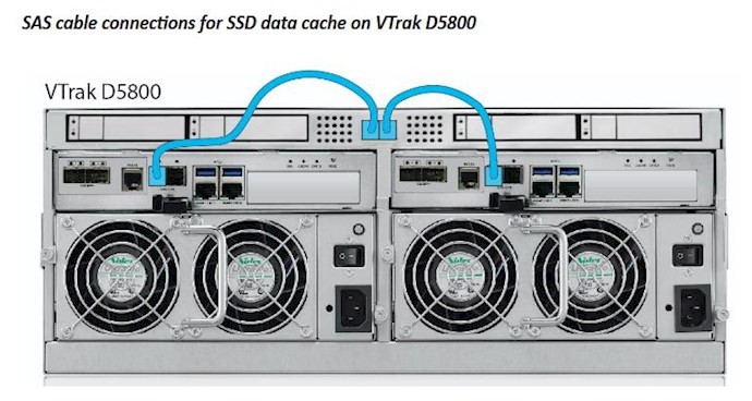

Hi Dean,
If you are using these in the 4 SSD cache bays of the D5800 make sure you have the SAS cables connected correctly.
If only one cable is sonnected then only 1 controller will be able to see the disks. The D5800 ships with 2 SAS cables for this purpose.
Dean Trasente posted this 09 May 2026
These drives are not used for cache. My 4 cache drives are already setup and working fine. These are simply physical drives to be used for storage. They are attached through a J5320 in 2.5 inch sleds which is attached to the D5800F. There are many other SSD in this JOBD which work fine on both channels. Only three of these new drives are having the issue. So it is not a cache controller related issue.
