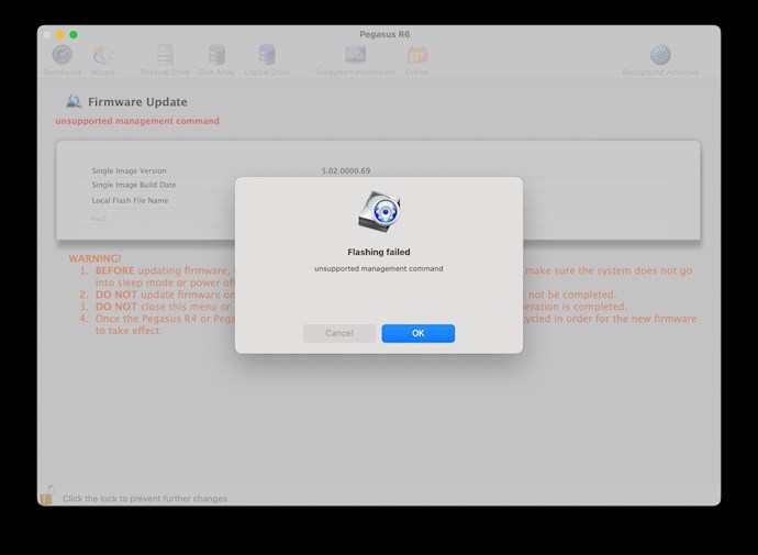

I've downloaded this firmware link. With my R6 mounted on my Intel iMac running Sequoia 15.0.1 and displaying as healthy in the Promise Utility (Current firmware is listed as 5.02.0000.69), I select Firmware Update from the Admin pulldown menu. It walks me throught the steps and has me choose this upate file from my Downloads folder....When I CONFIRM prompt the update I then get a FLASHING FAILED Unsupported Managment Command error
Am I doing something incorrectly?

Can you take a screenshot of the error and also a screenshot of the Promise Utility version and post them here?

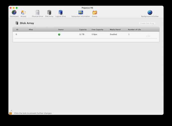

Jonathan Menell posted this 30 June 2026

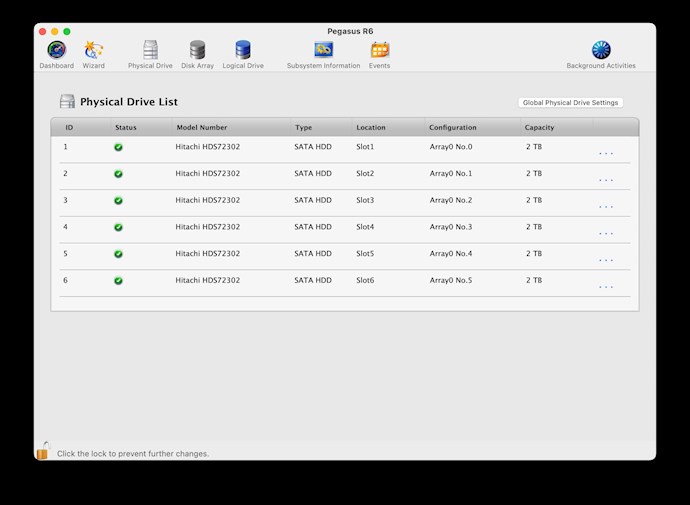

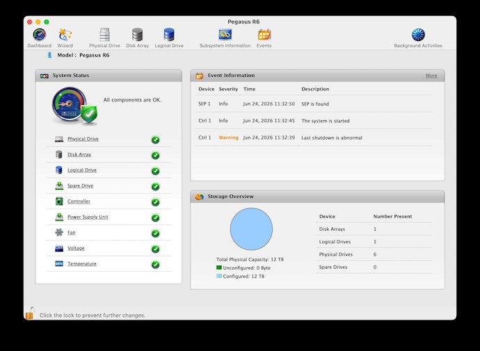

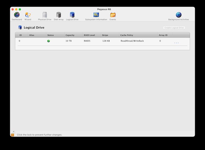

Haha. Sorry yes crystal balls need constant care. I tried to screen record my actual process but the file was too large so I've included screen shots of the various Promise Utility status screens as well as the error I get atempting to update the firmware

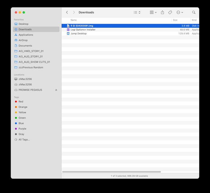

Also a screenshot of the file (from your link) that I'm directing it to in my downloads folderd folder

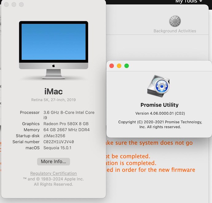

R P posted this 02 July 2026
Hi Jonathon,
Thanks for the screenshot of the error.
Please let me know which version of the Promise Utility are you using.
Jonathan Menell posted this 02 July 2026

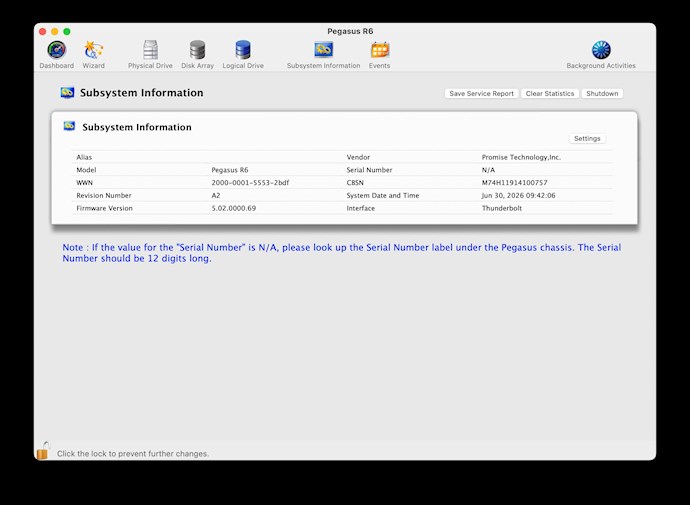

I have:
4.06.0000.01(C02)
Here's a screen shot with the iMac specs and the Utility version
