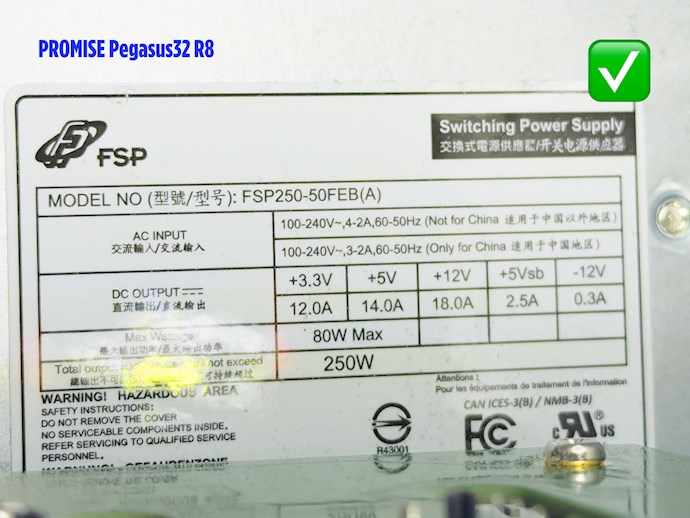

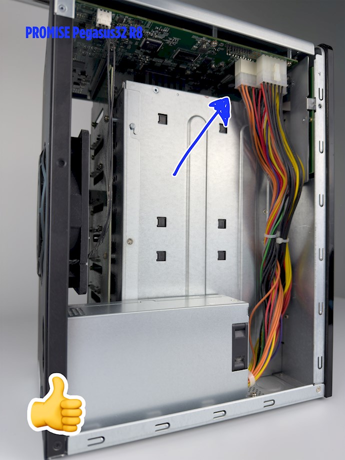

I have the same problem. After a power outage the power supply unit – probably – failed in my Pegasus32 R8.
Just a short question:
The unit which is in the Ebay link – FSP250-50LC with supposedly 320w –is a little different from my unit which is a
FSP250-50FEB(A) (see photos attached)
3 questions to you:
1) Do you have this exact unit from the Ebay link or did they send you another one which looks like mine? (the one in the Ebay link has black connectors – mine has white)
2) If you have the one from your link – is it 320w or is it actually 250w?
3) does the PSU that you got also only 2 connectors? 1x 24-pin and 1x 12-pin?
I bought here in Germany a replacement FSP250-50FEB (without the "(A)") but the connectors were all different and there were 9 instead of 2. I have to send this unit back.

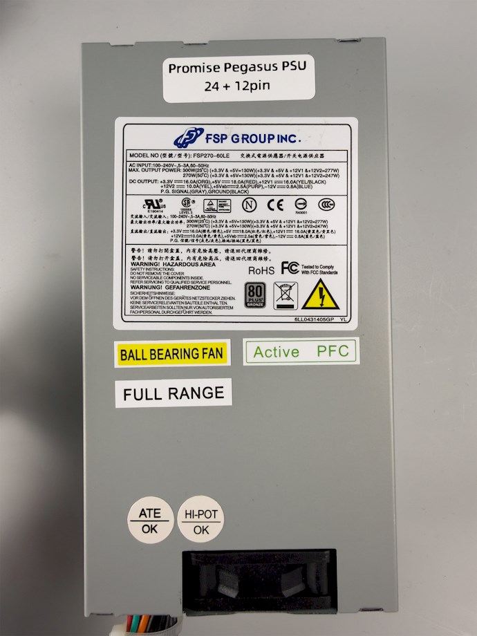

vanda trading posted this 12 May 2026
Here is a PSU with the 12pin proprietary Promise connector, available from the UK:
https://www.vanda-trading.com/promise-pegasus-12pin-psu
or here:
https//www.ebay.co.uk/itm/152603942091

Marc Perino posted this 20 May 2026
For all others out there – this is the PSU I got vom Vanda trading and it works perfectly.
It has a different model number but the right connectors/pins.
