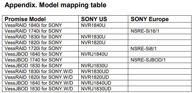

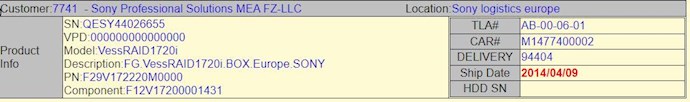

Frank Bosma posted this 29 September 2025
The serialnumber seems to indicate this is a OEM product for Sony Europe:
The available compatibility list shows that this results in a model NSRE-Si8/1:
You might be able to find supported firmware on Sony website.

Андрей Михайлов posted this 16 November 2025
Thanks, I got it.
