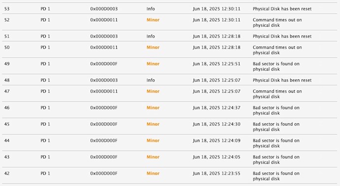

Ryan Iltis posted this 18 June 2025
Ok I will gro through the basic trouble shooting you listed -- THANK YOU! .  In poking around I have noticed that I have a drive going bad (screen shot attached).  Could this be causing the lock ups or do you think this is still a chassis issue.  Meanwhile in the promise utility the system isn't reporting any errors (besides the bad sectors on drive 1)
R P posted this 18 June 2025
Hi Ryan,
A bad disk can definately cause lockups, the entire RAID has to wait till that disk responds.
You might want to unseat that drive (if you have a RAID 5), pull it out an inch or so but leave it in the slot till you can get a replacement drive.
There's a documentary in here somewhere, "When good disks go bad". :-)
The second I pulled that drive out - it appears to have solved the problem.  Seriously - the amount of hours I have spent working on this.  :).
