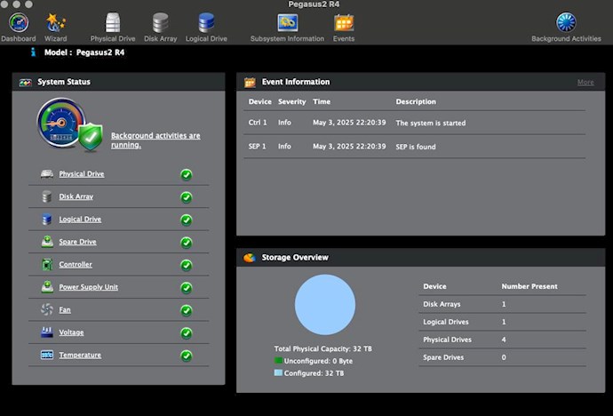

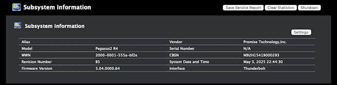

I updated my Mac Os to 15.4.1 and my (so far flawless) Pegasus 2 R4 is not mounting anymore,
I can see it on Disk Utility and it also shows on Promise Utility as ok.
I have reinstalled drivers, Reduced Security and All Kernel Extensions are Enabled.
Any ideas on how to proceed?

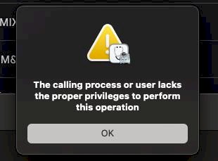

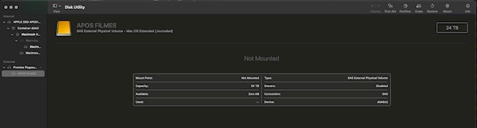

Lucas Barros posted this 04 May 2025

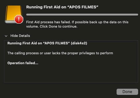

After trying differnt methods last night, now when I click on "mount" on Disk Utility, this is what I get.
I am the only user on this computer and also the admin.
R P posted this 05 May 2025
Hi Lucas,
Updates to 15.4 or 15.4.1 are causing some few issues.
If you can see the volume in Disk Utility and you can see the Pegasus in the Promise Utility, then the driver is working.
This appears to be a filesystem issue.
The first thing to do would be to run First Aid. This will probably fail to repair the filesystem. If First Aid does not work, the macOS goto solution is a program called Disk Warrior. It has fixed the filesystem in similar cases. Be advised that Disk Warrior is not free.

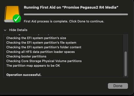

Lucas Barros posted this 06 May 2025
Hi RP, thanks for your answer and help.

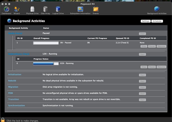

I ran disk utility first aid but yeah, it doesn't work. Only if I use it in the "parent drive" (pics follow). I'm waiting for the Redundancy Check on the Promise Utility to finish too.

R P posted this 06 May 2025
HI Lucas,
First Aid is a filesystem repair program. It failed to run on 'APOS FILMES' due to a permissions issue.

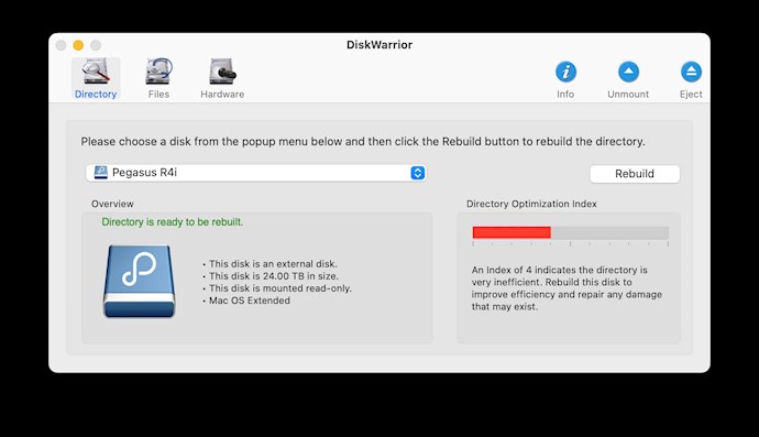

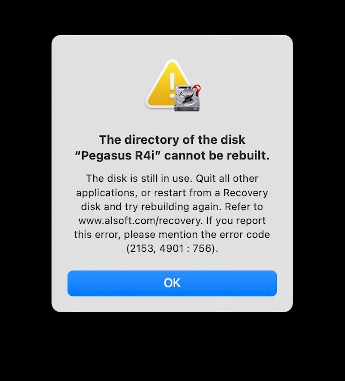

I am very familiar with DiskWarrior, and have DiskWarrior 5.3.1 (the latest release).  When I launch DW it evaluates the state of all HFS+ disks.  (DW canot work on APFS formatted disks because Apple still has not released sufficient technical specifictions for APFS.)  What DW does is build a completely new directory for the disk.  DW presents a comparison between the old and new directories, then if the user consents replaces the old directory.  This has long worked very well on HFS+ formatted disks.

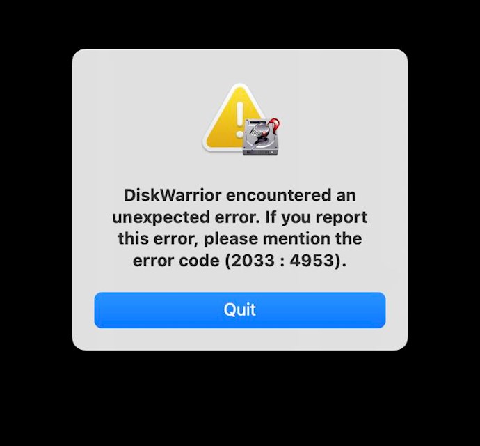

DW tells me my R4i has an optimization index of 4, meaning the disks are very fragmented and would benefit from DW rebuilding.  When I click Rebuild, I get these error messages.  My guess is DW cannot rebuild directories on a locked disk.

R P posted this 09 May 2025
Hi Tom,
You may have to umount the R4i volume before you can run Disk Warrior on it. Just eject it or drag it into the trash.
Even if it's mounted read-only I suspect that Spotlight will still try and index it, and that is probably the issue.

Tom Ritch posted this 31 May 2025
Good news.  I wanted to post these preliminary results since earlier I suggested Disk Warrior could not help.
I returned to this issue.  Nothing had helped.  I read R P's suggestion above, to unmount the R4i by dragging it to the trash.  I did, and got an error message that ithe R4i could not be unmounted, asked if I wanted to Force eject it, and warned of possible problems from Force Ejecting a disk.  I said OK, the R4i was unmounted, and then Disk Warrior could read, and it seems so far, repair it!  DW ran its standard rebuild of the R4i directory, presented the rebuilt directory, and asked if it should replace the old directory.  I said OK, and much to my surprise it successsfully replaced the directory.  It seems repairing the directory enabled writing to the R4i.  I saved the DW report on the repairs it made and will submit that to Promise in another thread.  I inspected the R4i in a Finder window and found that I could move files to new locations, showing Finder could now write to the disk.  This success encouraged me to do more with DW, so I am now having it check all files and folders for damage and potential compatibility problems.  More checking is needed to confirm that everything works, but so far so good.
