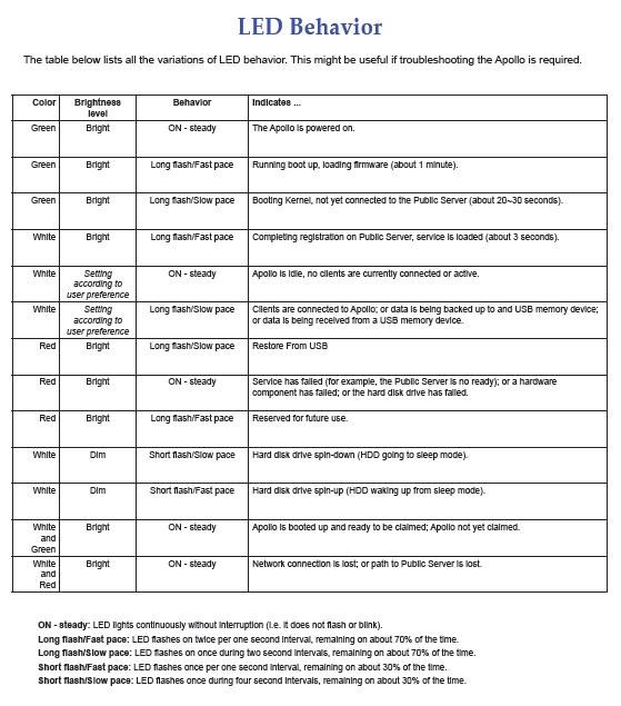

This is normal, the green LED means the Apollo is booting the white LED means that the Apollo has connected to the public serer.
