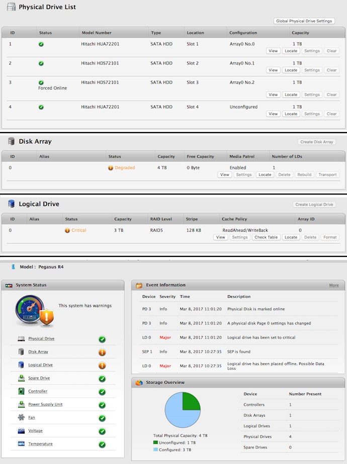

The LED is red - what does the Utility show its status as?
Jeffrey Cederberg posted this 08 March 2017
Here is the latest status:
Richard Oettinger posted this 08 March 2017
Good - force drive 3 online...
  • Liked by
  • Jeffrey Cederberg
Ooo... You sound hopeful.  :)
OK, I will try and see what happens...
Wait... I just want to make sure you really mean to try to force drive 3 online (the one that shows dead, though hopefully it's not).
Force drive 3, right?
Yes, the Dead ID 3
  • Liked by
  • Jeffrey Cederberg
Ok, here are the latest results after drive 3 was forced online:
Very good.
you have to start a rebuild now...

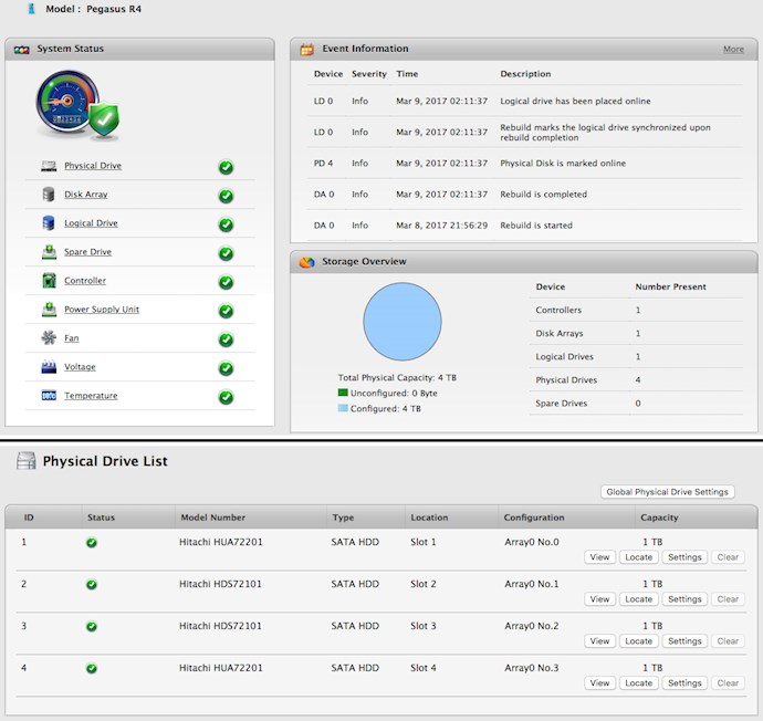

Jeffrey Cederberg posted this 09 March 2017
Thank you, Richard!
Everything is back to tip-top shape after the rebuild with no data loss!
